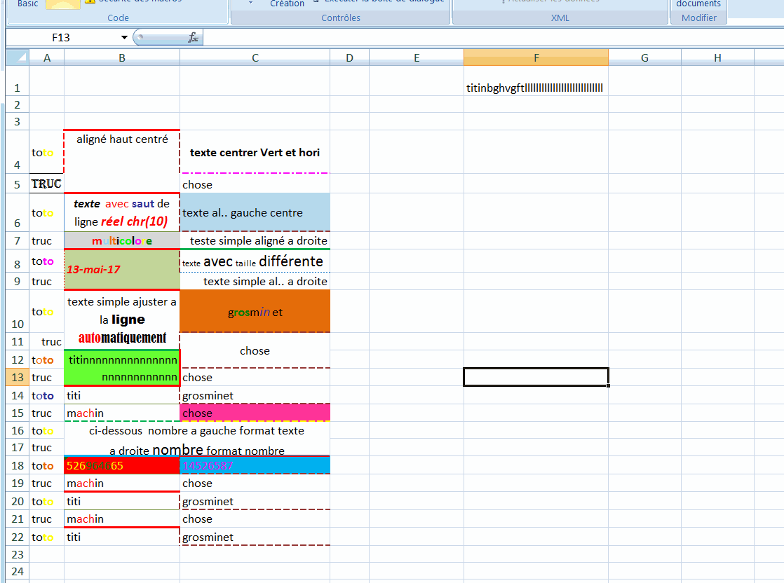

    Sub test()
    TableHtml = RangetoHTML(ActiveSheet.UsedRange)
    MailEnvoi "smtp.googlemail.com", True, "My.Mail@gmail.com", "Pasw", 465, 10, "My.Mail@gmail.com", "Vous.Mail@gmail.com", "Copy@gmail.com", "Suivi des modifications.", TableHtml, ""
    End Sub
    Function RangetoHTML(rng As Range) As String
    ' Changed by Ron de Bruin 28-Oct-2006
    ' Working in Office 2000-2013
        Dim fso As Object
        Dim ts As Object
        Dim TempFile As String
        Dim TempWB As Workbook
        TempFile = Environ$("temp") & "\" & Format(Now, "dd-mm-yy h-mm-ss") & ".htm"
        'Copy the range and create a new workbook to past the data in
        rng.Copy
        Set TempWB = Workbooks.Add(1)
        With TempWB.Sheets(1)
            .Cells(1).PasteSpecial Paste:=8
            .Cells(1).PasteSpecial xlPasteValues, , False, False
            .Cells(1).PasteSpecial xlPasteFormats, , False, False
            .Cells(1).Select
            Application.CutCopyMode = False
            On Error Resume Next
            .DrawingObjects.Visible = True
            .DrawingObjects.Delete
            On Error GoTo 0
        End With
        'Publish the sheet to a htm file
        With TempWB.PublishObjects.Add( _
             SourceType:=xlSourceRange, _
             Filename:=TempFile, _
             Sheet:=TempWB.Sheets(1).Name, _
             Source:=TempWB.Sheets(1).UsedRange.Address, _
             HtmlType:=xlHtmlStatic)
            .Publish (True)
        End With
        'Read all data from the htm file into RangetoHTML
        Set fso = CreateObject("Scripting.FileSystemObject")
        Set ts = fso.GetFile(TempFile).OpenAsTextStream(1, -2)
        RangetoHTML = ts.readall
        ts.Close
        RangetoHTML = Replace(RangetoHTML, "align=center x:publishsource=", _
                              "align=left x:publishsource=")
        'Close TempWB
        TempWB.Close savechanges:=False
        'Delete the htm file we used in this function
        Kill TempFile
        Set ts = Nothing
        Set fso = Nothing
        Set TempWB = Nothing
    End Function

    Merci Jean-Philippe,
    visiblement ça fonctionne mais ça m'envoit un fichier.bin, qu'est ce que c'est que cette bête ?????
    Merci Dysorthographie,
    mais mes connaissances sont trop maigres, je n'arrive pas à l'adapter pour qu'il fonctionne...

    maintenant la démo
    Nom : demo2.gif
Affichages : 1100
Taille : 943,9 Ko
    prendre un cliché d'un range
    et n'oublie pas de voter

    Oui Menhir
    j'envoie une 50aine de massage par jour avec excel si je devais uploader a chaque fois les images je ne m'en sort plus pour la table html c'est pareil si le destinataire ne sais pas comment il faut faire pour la récupérer c'est walouh
    comme OCR j'utilise abyfinereader je récupère pratiquement tout texte avec et il est pas tout jeune
    perso je pense a l'upload qui avec VBA est bloquant que se soit CDO,outlook,tune,etc......
    mais l'image reste une solution facile a mettre a place pour les débutants c'est vrai perso j'utilise le html et quelques astuce CSS (dans une balise style a l'intérieur du body) et html notamment le onwindow et même le Mime qui me permet quand même de retarder le destinataire indélicat de modifier le contenu
    je te garanti que si la personne n'a pas les connaissances suffisante si il essaie de copier ma table html même a la main sur un fichier texte avec extension html il aura des surprises hihihihihihihi
    voila voila

    Merci Patrick et Menhir pour l'intérêt que vous portez à mon problème et en lisant vos posts je me rend compte que vos connaissances sont "légèrement" supérieures aux miennes! sincèrement vous me parlez chinois!!!
    alors j'ai essayé vos deux macros, comme ça pas de jaloux!
    car effectivement moi je m'en fiche que ce soit une image ou pas, que ce soit dans le corps du message ou en pièce jointe... j'aimerai juste que chaque fin de mois je puisse envoyer mes 15 tableaux à mes 15 destinataires!
    alors Menhir :
    je ne doute pas que ta solution soit simple et évidente pour certaine mais sincèrement pas pour moi.
    j'ai bien changé le serveur, mis les adresses mails de l'expéditeur et du destinataire mais je ne sais pas ce qu'est le "tu n'a juste qu'a compléter le manque UsedRange par la plage de cellules que tu veux envoyer".
    Patrick:
    j'ai également essayé et là j'ai un message du type "erreur d'exécution 1004 Impossible de lire la propriété Text de la classe Characters."
    désolée mais je suis vraiment débutante et soyons francs, là ça dépasse mes capacités ! Ce n'est pas bien grave, je pensais que c'était plus simple que ça, je vais continuer à imprimer, le papier c'est bien aussi, c'est plus chaleureux :p
    Merci quand même !

    oui je suis bien d'accord avec toi mais sincèrement je n'arrive pas à le faire fonctionner ton code!
    à chaque fois il beug sur ".send", donc je n'ai pas du modifier correctement la sub test.
