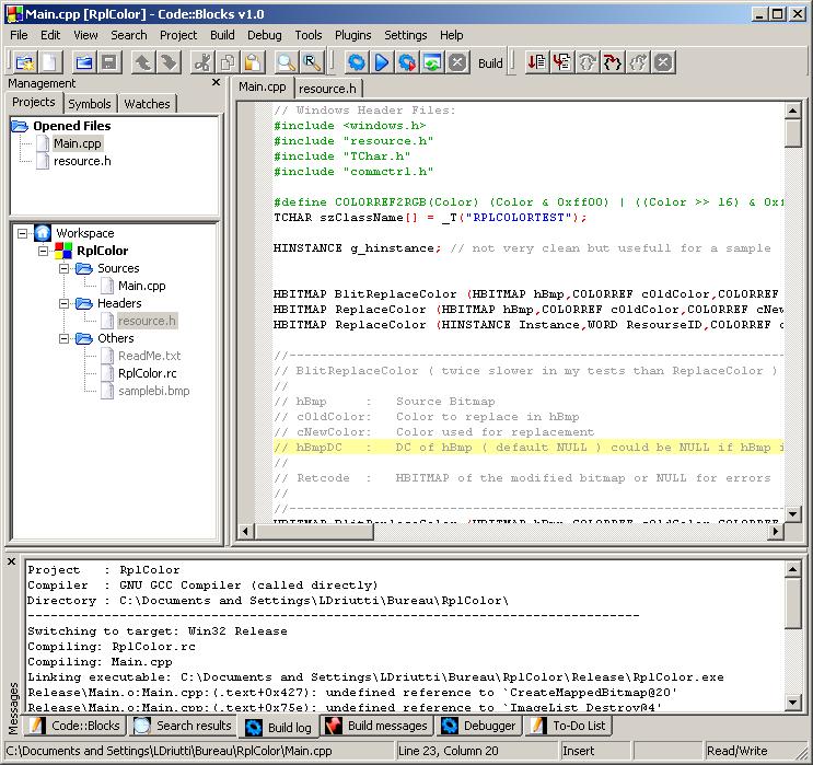

    http://www.codeproject.com/KB/graphics/rplcolor.aspxJ'ai trouvé ce code, mais j'arrive pas à le compiler, et vous? J'ai peut être mal configuré codeblocks...
    Ca marche chez quelqu'un?
    voici ce que le build log m'affiche :
    Project : RplColor
    Compiler : GNU GCC Compiler (called directly)
    Directory : C:\Documents and Settings\LDriutti\Bureau\RplColor\
    Switching to target: Win32 Release
    Compiling: RplColor.rc
    Compiling: Main.cpp
    Linking executable: C:\Documents and Settings\LDriutti\Bureau\RplColor\Release\RplColor.exe
    Release\Main.o:Main.cpp.text+0x427): undefined reference to `CreateMappedBitmap@20'
    Release\Main.o:Main.cpp.text+0x75e): undefined reference to `ImageList_Destroy@4'
    Release\Main.o:Main.cpp.text+0x8a6): undefined reference to `ImageList_DrawEx@40'
    Release\Main.o:Main.cpp.text+0x97a): undefined reference to `InitCommonControls@0'
    Release\Main.o:Main.cpp.text+0x9fa): undefined reference to `ImageList_Create@20'
    Release\Main.o:Main.cpp.text+0xa11): undefined reference to `ImageList_Add@12'
    Release\Main.o:Main.cpp.text+0xa29): undefined reference to `ImageList_AddMasked@12'
    Release\Main.o:Main.cpp.text+0xa6e): undefined reference to `ImageList_AddMasked@12'
    Release\Main.o:Main.cpp.text+0xab0): undefined reference to `ImageList_AddMasked@12'
    Release\Main.o:Main.cpp.text+0xaf5): undefined reference to `ImageList_AddMasked@12'
    collect2: ld returned 1 exit status
    Process terminated with status 1 (0 minutes, 3 seconds)
