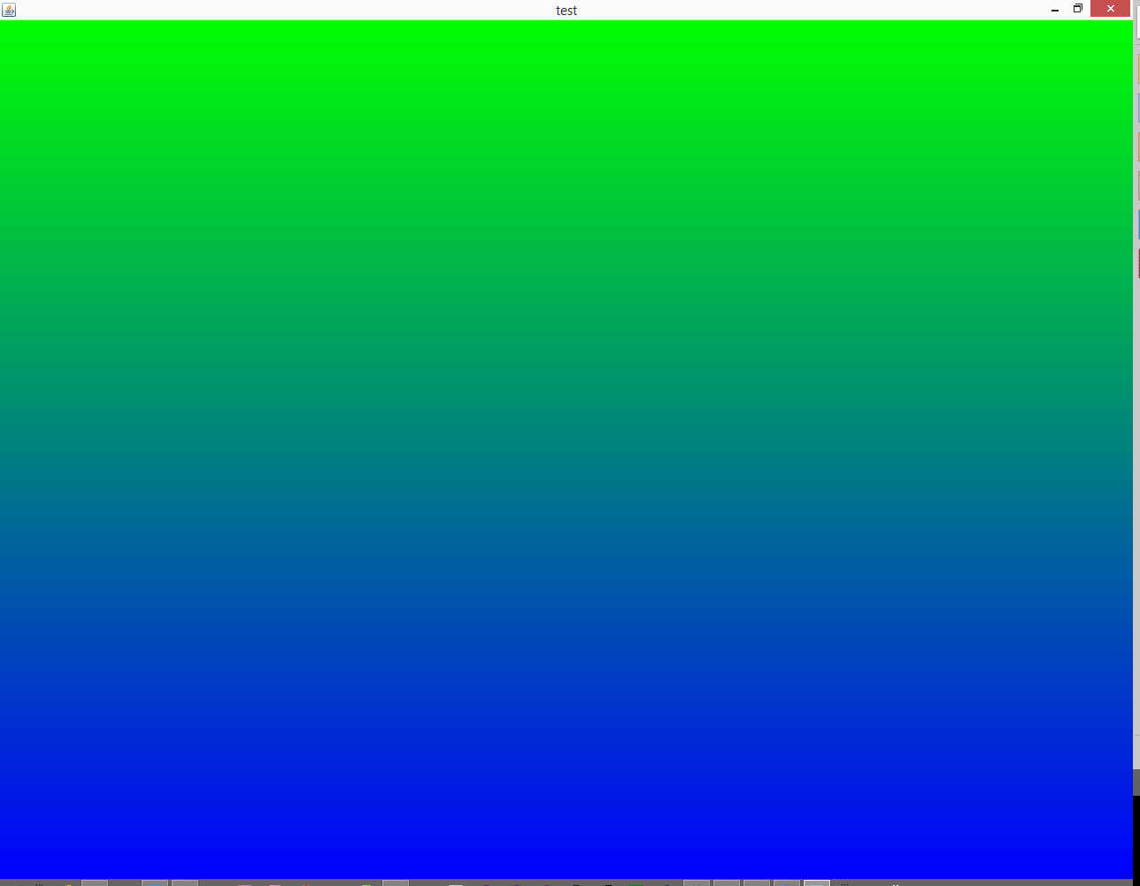

    Voilà ce que j'obtiens personnellement avec :
    public class TestGradient {
    		JFrame frame = new JFrame("test");
    		frame.setDefaultCloseOperation(JFrame.EXIT_ON_CLOSE);
    		frame.setContentPane(createPanel());
    		//frame.setContentPane(createRPanel());
    		frame.setSize(200, 200);
    		frame.setLocationRelativeTo(null);
    		frame.setVisible(true);
    	private static Container createPanel() {
    		JPanel panel = new JPanel() {
    			protected void paintComponent(java.awt.Graphics g) {
    				super.paintComponent(g);
    				Graphics2D g2d = (Graphics2D)g;
    				g2d.setPaint(createGradientPaint());
    				g2d.fillRect(0, 0, getWidth(), getHeight());
    			protected Paint createGradientPaint() {
    				return new GradientPaint(0, 0, Color.GREEN, 0, getHeight(), Color.BLUE);
    		panel.setBackground(Color.BLACK);
    		return panel;
    	private static Container createRPanel() {
    				double size = Math.min(getHeight(),getWidth())/2;
    				Rectangle2D bounds = new Rectangle2D.Double((getWidth()-size)/2, (getHeight()-size)/2, size, size);
    				g2d.setPaint(createGradientPaint(bounds));
    				g2d.fill(bounds);
    			protected Paint createGradientPaint(Rectangle2D bounds) {
    				return new RadialGradientPaint(bounds,
    						new float[]{0.0f,1f},
    						new Color[]{Color.WHITE,Color.BLACK},CycleMethod.NO_CYCLE);
    		return panel;
    Nom : Gradient.PNG
Affichages : 555
Taille : 13,9 Ko
