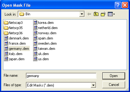

    If none of the samples matches your desired format and you know the symbols used, you can type your own. You can also check masks created for foreign languages to see if one of them would have the mask you need. To do this, click the Masks… button. This would call the Open Mask File dialog box:
    Nom : openmask1.gif
Affichages : 722
Taille : 17,6 Ko
    Click one file with a .dem extension and click OK. With the new mask in the Input Mask Editor, examine the samples in the Sample Masks list and select one. You can still customize any of the available masks.

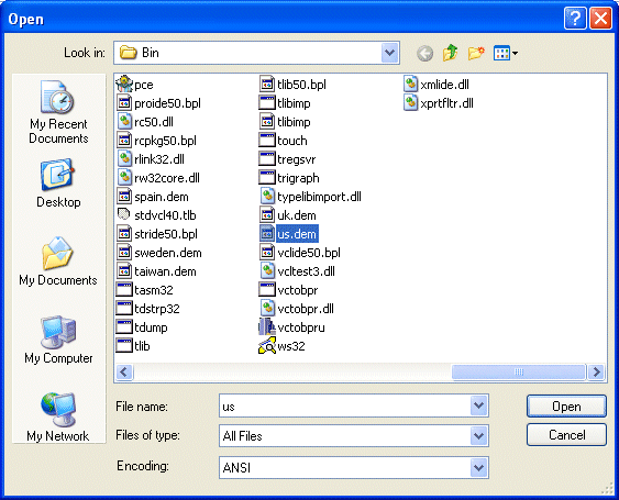

    This line is made of three sections. The first and the second, then the second and the third are separated by a beam. To see a sample file, using Notepad, locate the C:\Program Files\Borland\Cbuilder6\Bin folder. After changing the Files of Type to All files, click one of the files with .dem extensions:
    Nom : open2.gif
Affichages : 597
Taille : 47,7 Ko

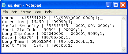

    Click Open:
    Nom : notepad1.gif
Affichages : 583
Taille : 12,2 Ko
    Create a new file following the example. Each mask is typed on its own line and press Enter at the end of each mask. To save the file, locate the C:\Program Files\Borland\Cbuilder5\Bin folder. In the Save dialog box, change the Save As Type to All Files. Type a name in one-word followed by an extension .dem extension. To use your list of masks, invoke the Input Mask Editor, click Masks… Locate the C:\Program Files\Borland\Cbuilder5\Bin folder. Change the Files of Types to All files. Click the file you created and click Open.
