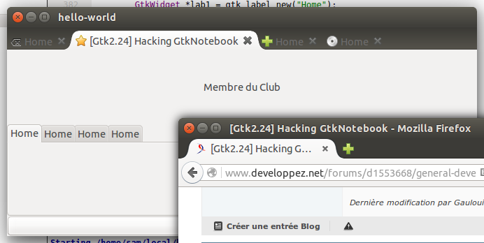

    Par défaut GtkNotebook Firefox tabs
    Nom : my_notebook.png
Affichages : 100
Taille : 52,9 Ko
    Nom : my_notebook_radiance.png
Affichages : 93
Taille : 16,9 Ko
    style "Unity" {
        # TODO rename background by bar-background
        MwbNotebook::background = "transparent linear-gradient(top, shade(@dark_bg_color, 0.96) 0px, shade(@dark_bg_color, 1.4) 100%) left top no-repeat no-repeat"
        MwbNotebook::background-insensitive = "@dark_bg_color"
        MwbNotebook::bar-border-bottom-color= "shade (@dark_bg_color, 1.1)"
        MwbNotebook::bar-border-top-color= "shade (@dark_bg_color, 1.09)"
        MwbNotebook::bar-border-bottom-style= solid
        MwbNotebook::bar-border-top-style= solid
        MwbNotebook::bar-border-bottom-width= 1
        MwbNotebook::bar-border-top-width= 1
        MwbNotebook::bar-padding-top = 6
        MwbNotebook::tab-background = "transparent linear-gradient(top, shade(@bg_color, 1.4) 0px, @bg_color 50%) left top no-repeat no-repeat"
        MwbNotebook::tab-border-top-path = "m 0,0 l 1,0"
        MwbNotebook::tab-border-right-path = "M 0,0 0.04,0 C 0.44,0 0.48,0.32 0.52,0.536 0.5614332,0.75973933 0.64,1 1,1"
        MwbNotebook::tab-border-bottom-path = "m 0,1 l 1,0"
        MwbNotebook::tab-border-left-path = "M 0,1 C 0.36,1 0.44,0.76 0.48,0.536 0.52,0.312 0.56,0 0.96,0 L 1,0"
        MwbNotebook::tab-border-left-color= "shade (@dark_bg_color, 1.1)"
        MwbNotebook::tab-border-top-color= "shade (@dark_bg_color, 1.1)"
        MwbNotebook::tab-border-right-color= "shade (@dark_bg_color, 1.1)"
        MwbNotebook::tab-border-left-width= 1
        MwbNotebook::tab-border-top-width= 1
        MwbNotebook::tab-border-right-width= 1
