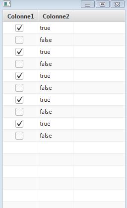

    Voici un exemple qui s’exécute comme prévu:
    la classe Main
    public class TableViewCheckBox extends Application{
      private TableView<Model>   table;
        @Override
        public void start(Stage stage) throws Exception {
             table =  new TableView<>();
            TableColumn<Model, Boolean> col1 = new TableColumn<>("Colonne1");
            col1.setCellValueFactory(cellData -> cellData.getValue().reservedProperty());
            col1.setCellFactory(CheckBoxTableCell.forTableColumn(col1));
            TableColumn<Model, Boolean> col2 = new TableColumn<>("Colonne2");
            col2.setCellValueFactory(cellData -> cellData.getValue().reservedProperty());
            table.getColumns().addAll(col1,col2);
            populate();
            StackPane root = new StackPane(table);
            Scene scene = new Scene(root);
            stage.setScene(scene);
            stage.show();
        private void populate(){
            for (int i = 0; i<10; i++ ){
                Model model = new Model();
                if(i % 2 == 0){
                    model.setReserved(true);
                else{
                    model.setReserved(false);
                table.getItems().add(model);
            launch(args);
    la classe Model:
    public class Model {
        private final BooleanProperty reserved = new SimpleBooleanProperty();
        public  BooleanProperty reservedProperty(){
            return reserved;
        public boolean getReserved(){
            return reserved.get();
        public void setReserved(boolean reserved) {
            this.reserved.set(reserved);
    capture d’écran:
    Nom : table.jpg
Affichages : 2398
Taille : 12,9 Ko

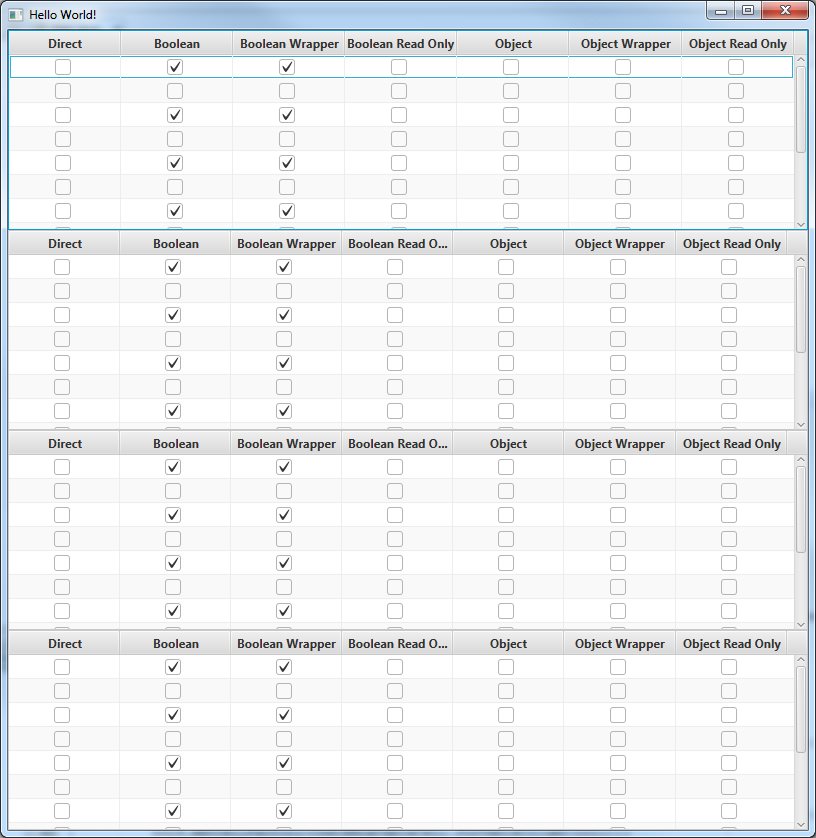

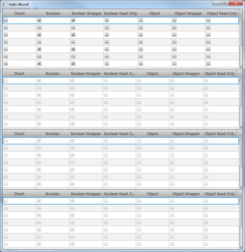

    Pour ce que j'en vois en testant le probleme ne vient pas du code. En fait, c'est un soucis dans la feuille de style CASPIAN :
    package tablecheck;
    import javafx.application.Application;
    import javafx.beans.property.ReadOnlyBooleanWrapper;
    import javafx.beans.property.ReadOnlyObjectWrapper;
    import javafx.beans.property.SimpleBooleanProperty;
    import javafx.beans.property.SimpleObjectProperty;
    import javafx.scene.Scene;
    import javafx.scene.control.TableColumn;
    import javafx.scene.control.TableView;
    import javafx.scene.control.cell.CheckBoxTableCell;
    import javafx.scene.layout.VBox;
    import javafx.stage.Stage;
    public class Main extends Application {
        @Override
        public void start(Stage primaryStage) {
            setUserAgentStylesheet(STYLESHEET_CASPIAN);
            final VBox root = new VBox();
            root.getChildren().add(createTable(true, true));
            root.getChildren().add(createTable(false, true));
            root.getChildren().add(createTable(true, false));
            root.getChildren().add(createTable(false, false));
            final Scene scene = new Scene(root, 800, 800);
            primaryStage.setTitle("Hello World!");
            primaryStage.setScene(scene);
            primaryStage.show();
        private TableView createTable(final boolean columnEditable, final boolean tableEditable) {
            final TableView<Boolean> tableView = new TableView();
            final TableColumn<Boolean, Boolean> col1 = new TableColumn("Direct");
            col1.setEditable(columnEditable);
            final TableColumn<Boolean, Boolean> col2 = new TableColumn("Boolean");
            col2.setEditable(columnEditable);
            col2.setCellValueFactory(feature -> new SimpleBooleanProperty(feature.getValue()));
            col2.setCellFactory(CheckBoxTableCell.forTableColumn(col1));
            final TableColumn<Boolean, Boolean> col3 = new TableColumn("Boolean Wrapper");
            col3.setEditable(columnEditable);
            col3.setCellValueFactory(feature -> new ReadOnlyBooleanWrapper(feature.getValue()));
            col3.setCellFactory(CheckBoxTableCell.forTableColumn(col1));
            final TableColumn<Boolean, Boolean> col4 = new TableColumn("Boolean Read Only");
            col4.setEditable(columnEditable);
            col4.setCellValueFactory(feature -> new ReadOnlyBooleanWrapper(feature.getValue()).getReadOnlyProperty());
            col4.setCellFactory(CheckBoxTableCell.forTableColumn(col1));
            final TableColumn<Boolean, Boolean> col5 = new TableColumn("Object");
            col5.setEditable(columnEditable);
            col5.setCellValueFactory(feature -> new SimpleObjectProperty<>(feature.getValue()));
            col5.setCellFactory(CheckBoxTableCell.forTableColumn(col1));
            final TableColumn<Boolean, Boolean> col6 = new TableColumn("Object Wrapper");
            col6.setEditable(columnEditable);
            col6.setCellValueFactory(feature -> new ReadOnlyObjectWrapper<>(feature.getValue()));
            col6.setCellFactory(CheckBoxTableCell.forTableColumn(col1));
            final TableColumn<Boolean, Boolean> col7 = new TableColumn("Object Read Only");
            col7.setEditable(columnEditable);
            col7.setCellValueFactory(feature -> new ReadOnlyObjectWrapper<>(feature.getValue()).getReadOnlyProperty());
            col7.setCellFactory(CheckBoxTableCell.forTableColumn(col1));
            tableView.getColumns().setAll(col1, col2, col3, col4, col5, col6, col7);
    //        tableView.getItems().setAll(Boolean.TRUE, Boolean.FALSE, null);
            tableView.getItems().addAll(Boolean.TRUE, Boolean.FALSE);
            tableView.setColumnResizePolicy(TableView.CONSTRAINED_RESIZE_POLICY);
            tableView.setEditable(tableEditable);
            return tableView;
            launch(args);
    Avec Caspian :
    Nom : check_editable_caspian.jpg
Affichages : 1652
Taille : 119,5 Ko
    Avec Modena :
    Nom : check_editable_modena.jpg
Affichages : 1793
Taille : 108,0 Ko
    A régler via les CSS donc en remettant l’opacité a 1 lorsque la checkbox est disabled et qu'elle se trouve dans une TableView ou une TableCell (voir avec ScenicView pour trouver le bon selecteur ou creer une cellule custom).
    Par défaut, ça doit être cette règle (extraite de la feuille de style Caspian dans 1.8_40) qui est appliquée :

    Citation Envoyé par win_ubuntu Voir le message
    la classe Main
        @Override
            populate();
            stage.show();
                if(i % 2 == 0){
                else{
            launch(args);
    la classe Model:
            return reserved;
    capture d’écran:
    Nom : table.jpg
Affichages : 2398
Taille : 12,9 Ko
    Merci pour cette réponse qui fonctionne parfaitement !!!
