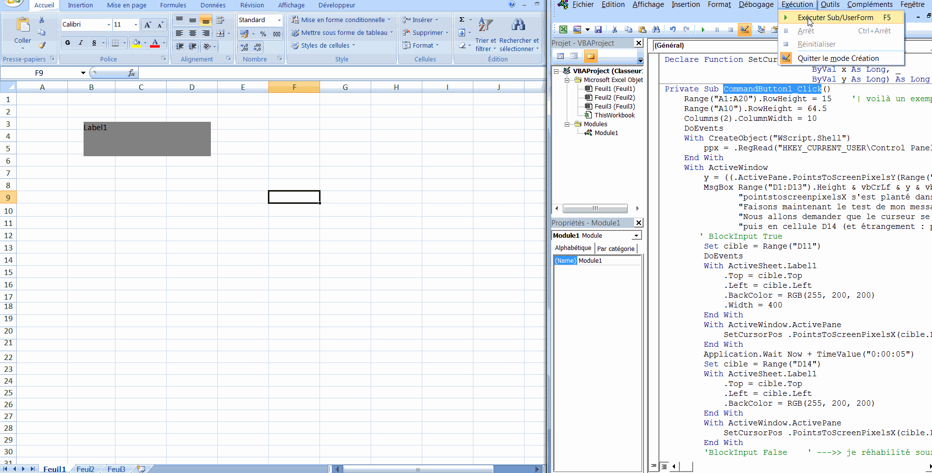

5 With ActiveWindow With CreateObject("WScript.Shell"): ppx = .RegRead("HKEY_CURRENT_USER\Control Panel\Desktop\WindowMetrics\AppliedDPI") / 72: End With y = ((.ActivePane.PointsToScreenPixelsY(Range("B4").Top) - .ActivePane.PointsToScreenPixelsY(0)) / ppx) / (.Zoom / 100) MsgBox Range("B1:B3").Height & " " & y End With
Pourriez-vous relire mon message 1008 d'hier soir?
Je viens de tester (à nouveau) avec ces codes :
Conclusion :Code:
85 Option Explicit Private Declare Function SetCursorPos Lib "user32" (ByVal x As Long, ByVal y As Long) As Long Sub Test_PointsToScreenPixelsZOOM() Dim i&, cible As Range For i = 50 To 400 Step 20 ActiveWindow.Zoom = i Set cible = Range("B4") With Label1 .Caption = "" .Top = cible.Top .Left = cible.Left .BackColor = RGB(255, 200, 200) End With With TextBox1 .Top = cible.Offset(1, 0).Top .Left = cible.Left .BackColor = RGB(255, 255, 255) .Text = ActiveWindow.Zoom & " " & (ActiveWindow.ActivePane.PointsToScreenPixelsX(cible.Offset(0, 1).Left) - ActiveWindow.ActivePane.PointsToScreenPixelsX(cible.Left)) / cible.Width End With With ActiveWindow.ActivePane SetCursorPos .PointsToScreenPixelsX(cible.Left), .PointsToScreenPixelsY(cible.Top) End With Stop Next End Sub Sub Test_PointsToScreenPixelsHAUTEUR() Dim i&, cible As Range, HauteurInitiale As Single HauteurInitiale = Rows(3).RowHeight ActiveWindow.Zoom = 300 For i = 1 To 100 Rows(3).RowHeight = Rows(3).RowHeight + 0.5 Set cible = Range("B4") With Label1 .Caption = "" .Top = cible.Top .Left = cible.Left .BackColor = RGB(255, 200, 200) End With With TextBox1 .Top = cible.Offset(1, 0).Top .Left = cible.Left .BackColor = RGB(255, 255, 255) .Text = ActiveWindow.Zoom & " " & (ActiveWindow.ActivePane.PointsToScreenPixelsX(cible.Offset(0, 1).Left) - ActiveWindow.ActivePane.PointsToScreenPixelsX(cible.Left)) / cible.Width End With With ActiveWindow.ActivePane SetCursorPos .PointsToScreenPixelsX(cible.Left), .PointsToScreenPixelsY(cible.Top) End With Stop Next Rows(3).RowHeight = HauteurInitiale ActiveWindow.Zoom = 100 End Sub Sub Test_PointsToScreenPixelsLARGEUR() Dim i&, cible As Range, LargeurInitiale As Single LargeurInitiale = Columns(1).ColumnWidth ActiveWindow.Zoom = 300 For i = 1 To 100 Columns(1).ColumnWidth = Columns(1).ColumnWidth + 1 Set cible = Range("B4") With Label1 .Caption = "" .Top = cible.Top .Left = cible.Left .BackColor = RGB(255, 200, 200) End With With TextBox1 .Top = cible.Offset(1, 0).Top .Left = cible.Left .BackColor = RGB(255, 255, 255) .Text = ActiveWindow.Zoom & " " & (ActiveWindow.ActivePane.PointsToScreenPixelsX(cible.Offset(0, 1).Left) - ActiveWindow.ActivePane.PointsToScreenPixelsX(cible.Left)) / cible.Width End With With ActiveWindow.ActivePane SetCursorPos .PointsToScreenPixelsX(cible.Left), .PointsToScreenPixelsY(cible.Top) End With Stop Next Columns(1).ColumnWidth = LargeurInitiale ActiveWindow.Zoom = 100 End Sub
- Le zoom ne change en rien la position du curseur
- La hauteur de ligne fait que le curseur n'est pas bien positionné par moment (ce n'est pas systématique)
- Idem pour la largeur de colonne
Peut-on en conclure que la méthode .PointsToScreenPixels ne fonctionne pas correctement?

EDIT2 : essayez cette macro plusieurs fois d'affilé (il s'agit du test de Jacques de cette nuit)...Code:
23 Sub Test_PointsToScreenPixelsSurFeuilleNeuve() Dim C, cible As Range, LargeurInitiale As Single For Each C In ActiveWindow.VisibleRange Set cible = C With Label1 .Caption = "" .Top = cible.Top .Left = cible.Left .BackColor = RGB(255, 200, 200) End With With TextBox1 .Top = cible.Offset(1, 0).Top .Left = cible.Left .BackColor = RGB(255, 255, 255) .Text = ActiveWindow.Zoom & " Left : " & ActiveWindow.ActivePane.PointsToScreenPixelsX(cible.Left) & " " & " Top : " & ActiveWindow.ActivePane.PointsToScreenPixelsY(cible.Top) End With With ActiveWindow.ActivePane SetCursorPos .PointsToScreenPixelsX(cible.Left), .PointsToScreenPixelsY(cible.Top) End With Stop Next End Sub
8 Sub unparia1010() With ActiveWindow Rows(2).RowHeight = Rows(2).RowHeight + 0.25 With CreateObject("WScript.Shell"): ppx = .RegRead("HKEY_CURRENT_USER\Control Panel\Desktop\WindowMetrics\AppliedDPI") / 72: End With y = ((.ActivePane.PointsToScreenPixelsY(Range("B4").Top) - .ActivePane.PointsToScreenPixelsY(0)) / ppx) / (.Zoom / 100) MsgBox Range("B1:B3").Height = y End With End Sub

re
bon me voila de retour
jacques j'ai testé ton code
j'ai simplement mis en commentaire blockinput et ajouter" activesheet." devant label1
j'ai une question;)
qu'a tu voulu me démontrer????????? la il faut m'expliquer
chez moi c'est nikel
je ne peut rien te dire de plus je vais examiner le code que tu a produit mais je vois pas ce que je peut faire
et pourtant je suis dans les plus mauvaise conditions (aero et dpi 120)
j'ai testé sur un fichier vierge
démo en image
Pièce jointe 296234
je t'en prie fait quelque chose avec ton XP ;)
