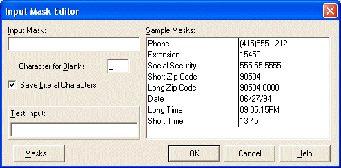

If you are familiar with the masking properties of this control, you can type a value using the appropriate symbols. Otherwise you should use an appropriate dialog box to guide you. You have two alternatives. You can double-click the empty area of the EditMask field or you can click the ellipsis button. This would call the Input Mask Editor dialog box
Pièce jointe 157035
Once there, you have various alternatives. The easiest way is to select one of the available formats in the Sample Masks list. Once you select a sample, its formatted mask displays in the Input Mask edit box. If the format is satisfying, you can click OK. Otherwise, you can add or delete symbols in the Input Mask edit box as you see fit.

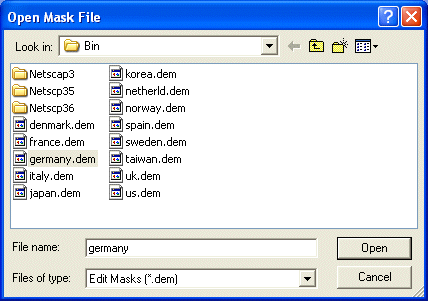

If none of the samples matches your desired format and you know the symbols used, you can type your own. You can also check masks created for foreign languages to see if one of them would have the mask you need. To do this, click the Masks… button. This would call the Open Mask File dialog box:
Pièce jointe 157036
Click one file with a .dem extension and click OK. With the new mask in the Input Mask Editor, examine the samples in the Sample Masks list and select one. You can still customize any of the available masks.

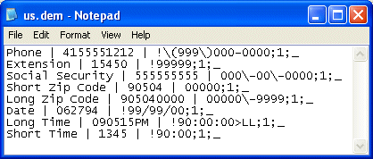

Another alternative is to create your own list of masks. To do this, follow the format used to create a mask. This is:
Name | Sample | Mask

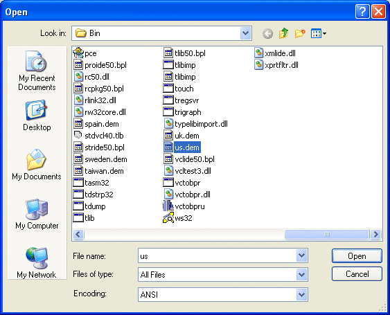

This line is made of three sections. The first and the second, then the second and the third are separated by a beam. To see a sample file, using Notepad, locate the C:\Program Files\Borland\Cbuilder6\Bin folder. After changing the Files of Type to All files, click one of the files with .dem extensions:

Click Open:
Pièce jointe 157038
Create a new file following the example. Each mask is typed on its own line and press Enter at the end of each mask. To save the file, locate the C:\Program Files\Borland\Cbuilder5\Bin folder. In the Save dialog box, change the Save As Type to All Files. Type a name in one-word followed by an extension .dem extension. To use your list of masks, invoke the Input Mask Editor, click Masks… Locate the C:\Program Files\Borland\Cbuilder5\Bin folder. Change the Files of Types to All files. Click the file you created and click Open.
