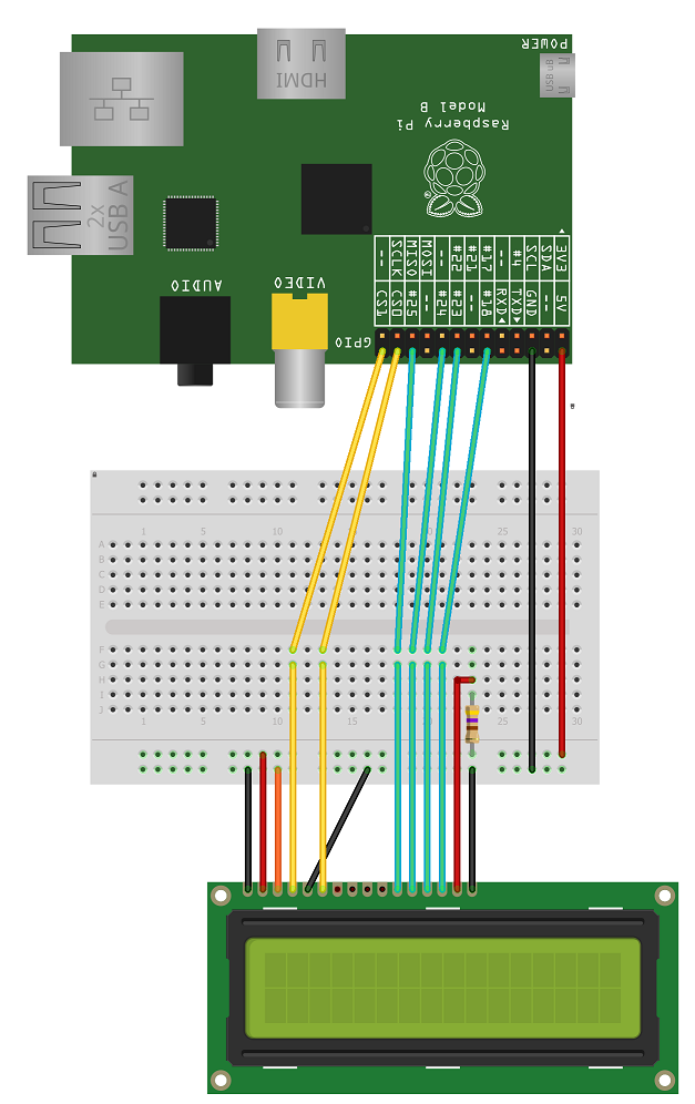

#!/usr/bin/python
# Imports                  #
import threading
import RPi.GPIO as GPIO
from time import sleep
import subprocess
# Class de controle du LCD #
class HD44780(threading.Thread):
	# Variable Shared    #
	_PULSE = 0.00005
	_DELAY = 0.00005
	# Constructeur       #
	def __init__(self, pin_rs=7, pin_e=8, pins_db=[25, 24, 23, 18], lcd_width=16):
		self.message = ""
		self.currentmessage = "azertyuiop"
		self.stop = False
		self.lcd_width = lcd_width
		self.pin_rs = pin_rs
		self.pin_e = pin_e
		self.pins_db = pins_db
		GPIO.setmode(GPIO.BCM) 				# Use BCM GPIO numbers
		GPIO.setup(self.pin_e, GPIO.OUT)
		GPIO.setup(self.pin_rs, GPIO.OUT)
		for pin in self.pins_db:
			GPIO.setup(pin, GPIO.OUT)
		self.Clear()
		threading.Thread.__init__(self)
