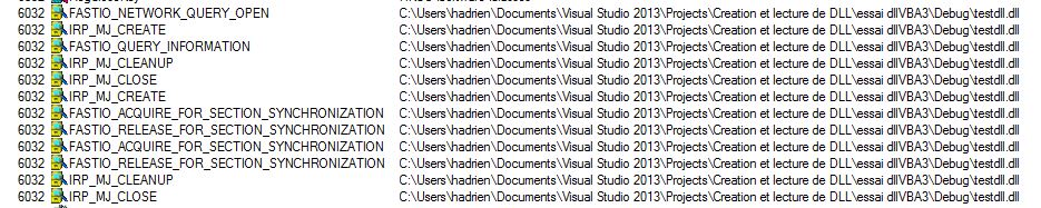

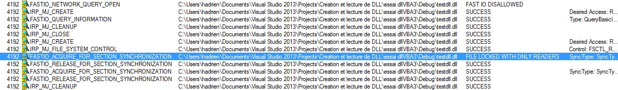

Avec dependency walker, la fonction square contenue dans la dll est visible mais voilà le log que je récupère:Code:
8 Public Declare PtrSafe Function square Lib "C:\DLL_VBA2.dll" (ByVal x As Integer) As Integer Sub test() Dim a As Integer Dim b As Integer a = 5 b = square(a) End Sub
Error: At least one module has an unresolved import due to a missing export function in an implicitly dependent module.
Error: Modules with different CPU types were found.
