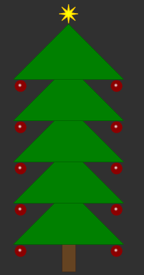

    Bonsoir !
    Voici un modeste essai de sapin de Noël.
    Pour faire les boules, j'ai copié le code des bombes du Démineur de Paul Toth.

    {$FRAME_WIDTH 210}
    {$FRAME_HEIGHT 400}
    {$BACKGROUND $303030}
    program Sapin;
    uses
      Flash8, Couleurs, Etoile;
    { --- Extrait modifié de FlashMine.fpr --------------------------------------- }
    type
      TBoule = class(MovieClip)
        constructor Create(Name: string; x, y, c, d: Integer);
        procedure Circle(radius: Integer);
        procedure IsBomb(color: Integer);
      end;
      TMatrix = class
        matrixType: string;
        x,y,w,h   : Double;
        r         : Double;
        constructor Create;
      end;
    var
      Boules  : array[0..9] of TBoule;
      Matrix : TMatrix;
    constructor TBoule.Create(Name: string; x, y, c, d: Integer);
    begin
      inherited Create(nil, Name, d);
      _x := x;
      _y := y;
      IsBomb(c);
    end;
    procedure TBoule.Circle(Radius: Integer);
    var
      a    : Double;
      c1,s1: Double;
      c2,s2: Double;
      r2   : Double;
    begin
      a := 3.14/4;
      c1 := cos(a);
      s1 := sin(a);
      a := 3.14/8;
      c2 := cos(a);
      s2 := sin(a);
      r2 := 11 * Radius/10;
      moveTo(0,Radius);
      curveTo( r2*s2, r2*c2, Radius*s1, Radius*c1);
      curveTo( r2*c2, r2*s2, Radius,0);
      curveTo( r2*c2,-r2*s2, Radius*s1,-Radius*c1);
      curveTo( r2*s2,-r2*c2, 0,-Radius);
      curveTo(-r2*s2,-r2*c2,-Radius*c1,-Radius*s1);
      curveTo(-r2*c2,-r2*s2, -Radius,0);
      curveTo(-r2*c2, r2*s2,-Radius*c1, Radius*s1);
      curveTo(-r2*s2, r2*c2, 0,Radius);
    end;
    procedure TBoule.IsBomb(color: Integer);
    begin
      lineStyle(0, color);
      beginGradientFill('radial', [$ffffff, color], [100,100], [0,255], Matrix);
      circle(8);
      endFill;
    end;
    constructor TMatrix.Create;
    begin
      matrixType := 'box';
      x := -4.5;
      y := -4.5;
      w := 6;
      h := 6;
      r := 0;
    end;
    { --- Fin de l'extrait ------------------------------------------------------- }
    var
      Etoile: TEtoile;
      i: Integer;
    begin
      with _root do
      begin
        lineStyle(0, Bistre);
        moveTo(100-10, 355);
        beginFill(DarkBrown);
        lineTo(100+10, 355);
        lineTo(100+10, 395);
        lineTo(100-10, 395);
        lineTo(100-10, 355);
        endFill();
        lineStyle(0, DarkGreen);
    	for i := 0 to 4 do
    	begin
          moveTo(100, 275-60*i);
          beginFill(Green);
          lineTo(100+80, 355-60*i);
          lineTo(100-80, 355-60*i);
          lineTo(100, 275-60*i);
          endFill();
        end;
      end;
      Matrix := TMatrix.Create;
      Boules[0] := TBoule.Create('cell_0', 020+10, 355+10, DarkRed, 0);
      Boules[1] := TBoule.Create('cell_0', 180-10, 355+10, DarkRed, 1);
      Boules[2] := TBoule.Create('cell_0', 020+10, 295+10, DarkRed, 2);
      Boules[3] := TBoule.Create('cell_0', 180-10, 295+10, DarkRed, 3);
      Boules[4] := TBoule.Create('cell_0', 020+10, 235+10, DarkRed, 4);
      Boules[5] := TBoule.Create('cell_0', 180-10, 235+10, DarkRed, 5);
      Boules[6] := TBoule.Create('cell_0', 020+10, 175+10, DarkRed, 6);
      Boules[7] := TBoule.Create('cell_0', 180-10, 175+10, DarkRed, 7);
      Boules[8] := TBoule.Create('cell_0', 020+10, 115+10, DarkRed, 8);
      Boules[9] := TBoule.Create('cell_0', 180-10, 115+10, DarkRed, 9);
      Etoile := TEtoile.Create(nil, '', 10);
      Etoile._x := 100;
      Etoile._y := 20;
      Etoile.tracerUneEtoile(4, 14, 8, Tangerine, Yellow);
    end.

    Une version améliorée, avec un début d'animation.

    J'ai amélioré le dessin de l'arbre, remplaçant les droites par des courbes.
    J'ai ajouté aussi une variation dans l'allumage des boules.

    Voici le dernier état de mon arbre de Noël.

      Boules[6] := tBoule.Create('b6', 180-10, 295+10, Violet, 3);
      Boules[2] := tBoule.Create('b2', 020+10, 235+10, Violet, 4);
      Boules[7] := tBoule.Create('b7', 180-10, 235+10, Violet, 5);
      Boules[1] := tBoule.Create('b1', 020+10, 175+10, Violet, 6);
      Boules[8] := tBoule.Create('b8', 180-10, 175+10, Violet, 7);
      Boules[0] := tBoule.Create('b0', 020+10, 115+10, Violet, 8);
      Boules[9] := tBoule.Create('b9', 180-10, 115+10, Violet, 9);
      Etoile := tEtoile.Create(nil, '', 11);
      Etoile._x := 100;
      Etoile._y := 20;
      Horloge := tHorloge.Create;
      stage.displayState := 'FullScreen';
    end.
